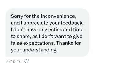

Hey Lizzy, these instructions don't work. When you log in with your child account we get the message "Can't use fitbit with this google account This could be because you're using a workspace account or because your account is supervised".... OF COURSE this is a supervised account, as it is required for the Ace 3 and to setup your child in family link. There are no escape to this loop and customer support knows it. The issue is on the DEV side, NOT on the user side. The first few times I have called support they were sending me pseudo-instructions like the one you mention, knowing they don't work. But then when you start saying them what the real issue is (fitbit does not support family link, but family link is required for the Ace 3) they admit that not only the issue is on their side but that there are no estimates on when the issue will be fixed. This is completely unacceptable.

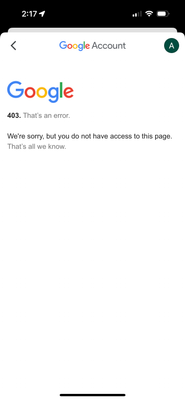

@LizzyFitbit I’ve done all of the recommendations, but keep getting a 403 error when I try to link my child’s account to Fitbit. This has been a huge waste of time and very frustrating logging in in circles for nothing to happen…now new gift that’s unusable. Pleas help!!

So I have been liaising with Fitbit Support today telling them how ridiculous this seems.
Their final response has been:
Sorry for the trouble. The intention of this is not for you to buy a new phone for your son, but the Fitbit Ace now has to be setup directly on the Kid's device and logged in from the kid's account, no longer within the Fitbit app. This was a change in how the App interacts with the Fitbit App. Thanks for your understanding.
