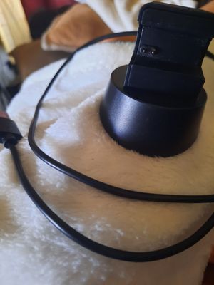

This is our charger. It has no reset button. How do I reset this one?
