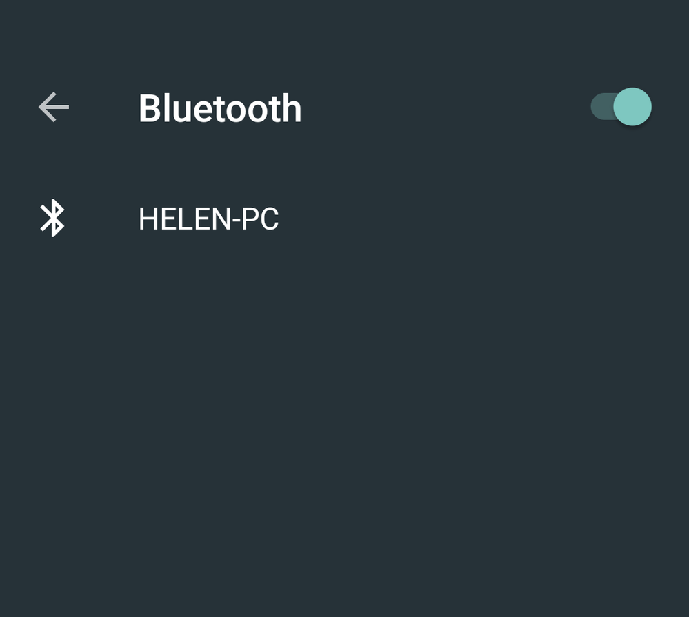

I have solved my problem. Not with the suggestion above but after trying everything under the sun and nothing working I decided to unpair it with my blue tooth and re-pair it, I hadn't done that until now .As soon as I took Fitbit off my Bluetooth the app started syncing. It dosent make sense but my Fitbit is not paired with my phone Bluetooth but it's syncing  every time I open the app. Working perfectly.
I have Moto G5 phone .
I could take a photo of my paired devices and you can see Alta is not there but I can't upload it here.

As you can see by the screenshot the Alta is no one paired   it was there originally until I removed it. Whatever it is it's working perfectly. Maybe it was causing some confliction with something.As you can see by the screenshot the Alta is no one paired it was there originally until I removed it. Whatever it is it's working perfectly. Maybe it was causing some confliction with something.
Thanks. I was having trouble with the same phone. As of now, it is syncing.
Ah that's great. It must be the phone causing conflict so   just check from time to time because it connects back up with Bluetooth .
Welcome to the Community @Mrsheitz! Good to hear that you are syncing now with your Moto G5. Awesome help @Twigsahearn! I really appreciate that you are sharing this screenshot and I'm glad to hear that is helping others as a workaround for syncing issues with the Moto G5 while our team is working to add it to the supported devices list.
