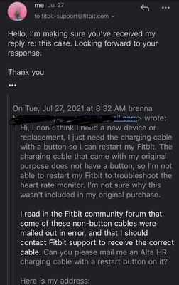

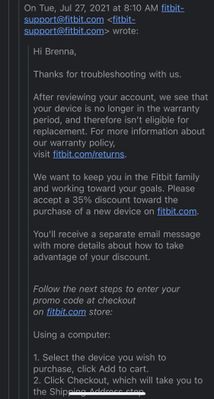

How did you get them to send you a new one? My charging cable never had a button, which I never needed until now — I’m trying to troubleshoot why my heart rate monitor is not working. Customer support said it’s beyond my warranty and they can’t replace my Fitbit. But I just need a charging cable with a button on it
Hello, I contacted Fitbit support, here’s what happened:
Moderator edit: merged reply

It’s been a few days and I haven’t had a reply. Do you have any recommendations?
