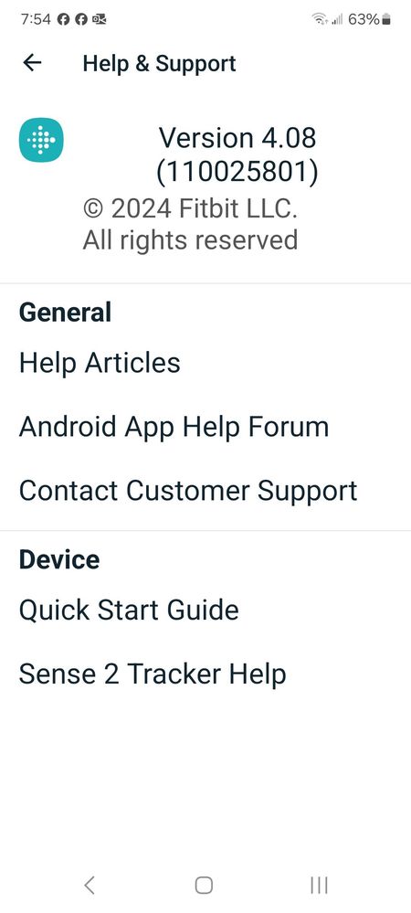

My app is updated to 4.08 and I am still have the same problem - Afib section is grayed out.
See attached screen shot of my version. I also uninstalled and reinstalled. Same problem.

@AngieBayLeaf Welcome to the forums. Thanks for the screenshot. A new version of the app is coming soon. Please wait for this update and check if this is resolved. If not, please post again here. We will continue monitoring the situation. For the most part it seems to be resolved. We shall see if other users are experiencing the same. Thanks for your patience!
In the mean time please try setting up your Fitbit as a new device. Open the Fitbit app and tap on the "smartphone + Fitbit" symbol. Tap then on "add more devices". Select yours from the list and follow the instructions on screen. Try to set up afib notifications again. Thanks in advance!
