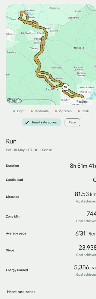

Best AnswerI just got v4.23 pushed to my phone and I can now again open the detailed map on hiking activities > 4hrs.
They also load a lot faster. Also when tapping the small map, although I then cannot zoom in and out nor can I move the map around...

As mentioned, now I can at least view my activities. Yesterday had a Hiking activity of 4h22m. Smoothly opens the map: great.
