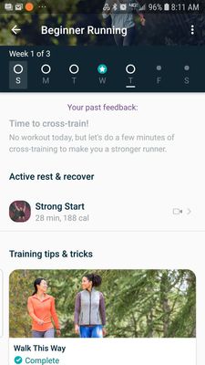

I appreciate your effort and patience troubleshooting your device with the information that was shared on my previous post. To better assist you with this, can you please send me a screenshot of the previous days in which the device didn't recorded the workouts? Please refer to this post for instructions of how to attach an image into your post.
Looking forward to your reply.
Spoiler
Here are the screenshots.

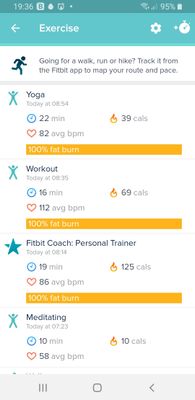

In my Number of days exercised, the session is recorded as completed and gives relevant data, but in the run training program it displays as 0 workouts

All of the workouts are recorded in the Number of days exercised, and also in the Fitbit Coach app, by the way.
