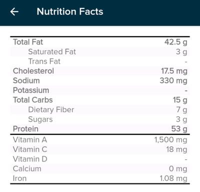

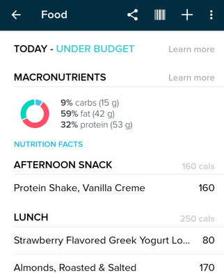

Evidence 1
All food in the following screenshots are logged as 1 serving. The Nutrition Facts page is correct and it agrees with the Macro information displayed on the Food Page. This is functioning properly.

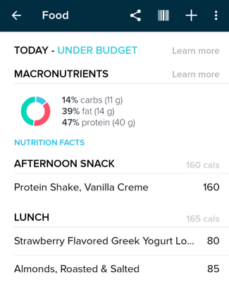

Evidence 2
Now I have changed my Almonds to reflect ½ serving. The nutrition page is unchanged, it still reflects 1 serving of almonds, and everything else, which is now incorrect. However the macro info on the food page has updated properly.

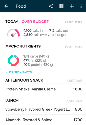

Evidence 3
Now i have changed my log to reflect 10x servings of everything. Again the nutrition facts page still reflects 1x serving, which is incorrect, while the macros info on the food page is correct.
Summary
The app is not performing the portion size calculations at all on the Nutrition Facts page. Anything logged as 1 serving is properly calculated, but anything logged as greater than or less than 1 serving does not have math performed on the nutrition facts as it should be.
