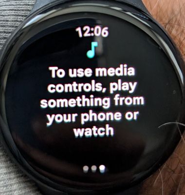

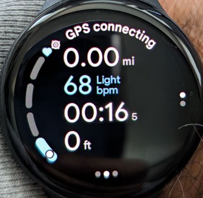

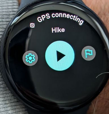

This isn't on the tile carousel, this is during a workout. So you select a workout, like "Hike" from the exercise menu, or even from the "Quick start" tile, and it launches you into the exercise screen. Once launched, it tells you things like heart rate, time elapsed, calories etc... But you can swipe right, where the screen then allows you to pause the workout, or end the workout. Swiping left gave you extra stats like average pace, elevation gained. But it's this latter swipe that doesn't show stats anymore, it just shows a media control screen.
I have the same issue as @cn198.
Specifically while tracking hiking, the 2nd screen showed additional stats. But now the 2nd screen seems to have been replaced by "to use media control".
Under the Hike settings -> Stats displayed, it shows only 4 slots, and elevation gained can be selected for one of the slots. I don't know know if the previous version had option for more slots because I was happy with the default stats reporting.
This seems to be a downgrade in the feature set, and it doesnt make sense. I hope it gets restored to be display more stats as it used to.
The Hike settings have always shown a limited number of slots, with those options, so that hasn't really changed I don't believe. It's just this swipe left screen that's now changed. It's also not limited to the hike workout, the spinning one does it too. It's very annoying as I used those additional stats a lot.

Ok so I've just had a baffling chat session with Fitbit support. Their advice was "in the Fitbit app, look for exercise settings. See if there are options to customize the data screens displayed during workouts." Not entirely helpful to solving the problem. But they went on to say... "I've checking with my team and the exercise stats screen has been replaced with a non-interactive media control screen on the Google pixel watch 2."
I am absolutely baffled that a device for measuring and improving performance would remove away most of the stats for a workout and replace it with a screen that does nothing. I almost don't believe that's true. Surely it has to be a bug!
Adding picture for more clarity if needed.
Hike Start/1st Screen/2nd Screen:
