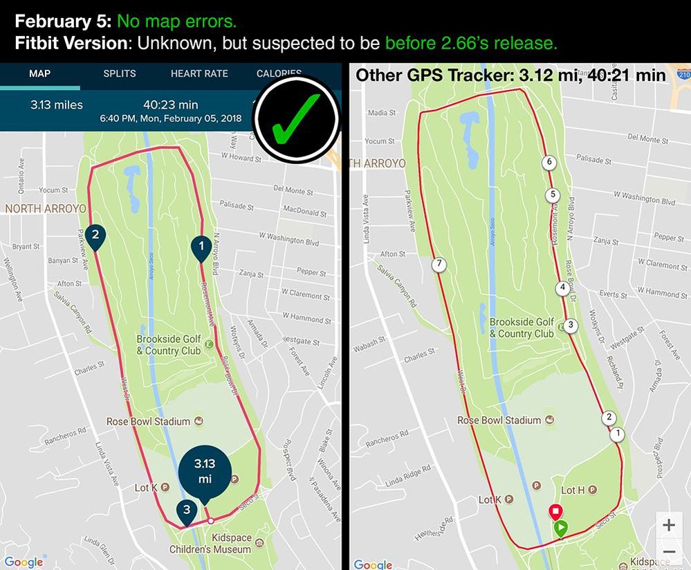

For starters, here are two examples of Connected GPS working as expected. I suspect this was before the release of Fitbit 2.66:

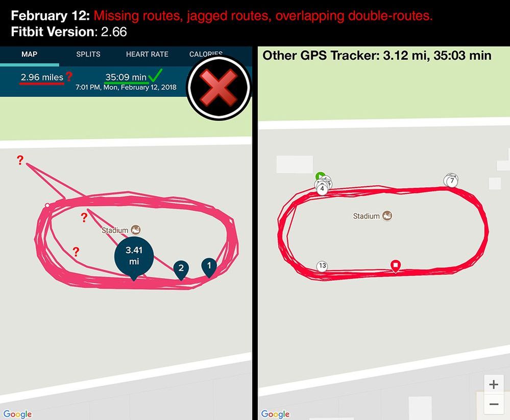

Like others have reported, my Connected GPS results have been filled with gaps, jagged/jumpy lines, and inaccurate distance information.
The problems I am experiencing with my GPS map inaccuracies/errors started sometime between February 8 and February 10 (my February 8 workout GPS map was fine, I took a break on February 9, and on February 10 I spotted the first map errors). This time frame coincides with multiple users who reported that their errors started around February 9 (both in this thread and in the other thread, "Charge 2 not recording distance correctly."), even though Fitbit 2.66 released on February 5, according to the Android App forum. My Google Play is set to auto-install app updates, so I am not sure when my phone installed Fitbit version 2.66, which is the current version that generates errors.
My Settings:
Attempted Solutions:
Below are some screenshots comparing my Charge 2 Connected GPS maps with another device recording the same fitness activities concurrently...
Some users reported problems starting on February 9. I didn’t work out that day, but on February 10 I noticed that something had changed (perhaps with Fitbit 2.66); my Charge 2’s Connected GPS map and distance started to yield missing routes and produce jagged routes and overlapping double-routes:
Oddly enough, I managed to get an accurate-looking map on February 14 without any fiddling. The distance was off though:
On a side-note, which might be related to the GPS/distance bugs, I have noticed that starting with Fitbit version 2.66, even with All-Day Sync, Always Connected, and Keep-Alive Widget turned ON, my Charge 2 takes much longer to Sync manually and does not automatically Sync as frequently as it did just a week before the errors detailed below started. Keep-Alive Widget is persistently located in my notifications but seems to do nothing. I can confirm that my phone has given Fitbit all the proper Permissions (see "My Settings" section above). Most times, manual Sync fails and I have to turn Bluetooth on/off and reattempt multiple times. This persists even after clearing the cache and data, and reinstalling the app. My general inference is that the latest patch impaired the connection between my phone and Charge 2.
