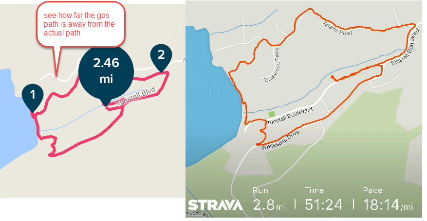

I took 2 cells phones and myself for a walk. One set to Fitbit app the other to Strava app.
Clearly the Fitbit GPS is faulty. This inaccuracy naturally gets added to the total distance walked and why there is a .4 mile difference between the 2 apps.

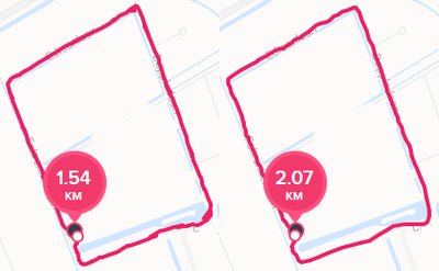

Since a couple of days, I guess since last Android app update, I too have the same problems with inaccurate GPS results using my Charge 2 with my Moto G5 Plus.
We walk the same 2.1km path during our lunchbreak and today (Monday) it was only 1.54km, last week on Wednesday it was still 2.07.
(Today vs 5 days ago)
