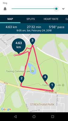

OK, so I did a parkrun (5km) this morning using the downgraded app (v2.65). The map looks better, less jagged lines but in the past Fitbit measured the run as at least 4.8km, and this comes out as 4.6, still a big improvement on 3.23km from last week!
As per my previous post, I use Strava as a middleman to save all my exercise ultimately to Google Fit should I change my tracker in the future I don't lose my data (which given the current situation feels more likely!!), on Strava I can recalculate the distance where presumably Strava remeasures the map rather than using the distance data from Fitbit, it corrected today's run to 5km which should be correct and gives a more accurate pace. I'm attaching photos of today's parkrun compared to last weeks then the Strava correction of today's run, should any of that be of interest.Today's run Fitbit v2.65Today's run Fitbit v2.65
Last week's run Fitbit v2.66Last week's run Fitbit v2.66
Today's run (Strava recalc of distance)Today's run (Strava recalc of distance)I wonder if the Android security patch update could also be at play here?

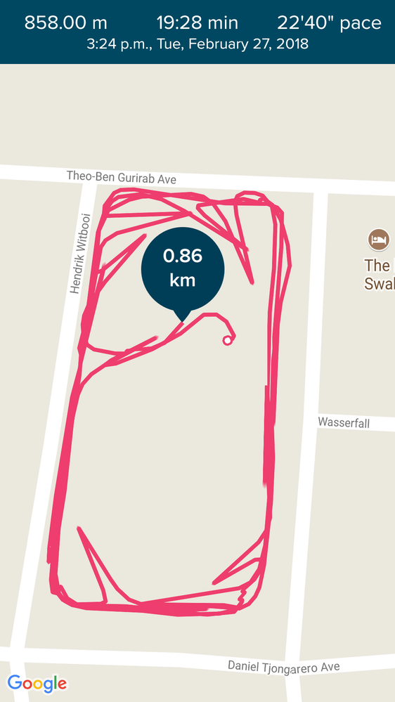

Says I walked only 860m with a pace average of 22 min a km. ...
I walked. ... not crawled
