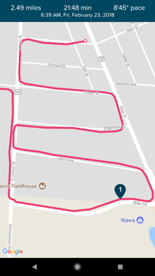

Just wanted to also confirm that under version 2.65.1, the issue is resolved: pace, distance, and connected GPS path are all correct once again. See below:
Before on v2.66
After on v2.65.1
Sorry if you already know the root cause and all, Fitbit folks, but... just wanted to weigh in.
