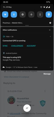

I'm owner of a Charge 3 paired to an Android device. Recently (couple of weeks?) I noticed that my phone battery is draining much faster than usual on most days when that message is appearing. At the time I'm writing, I woke up, and I confirmed that the Charge 3 correctly tracked my sleep, yet the GPS has been running since yesterday evening. Please note that yesterday evening I didn't have any tracked activity. Rebooting the tracker did not solve the problem. Closing the app did not help either (the message from Fitbit comes with a system notification that Google Play services app is using GPS). I started to investigate and found that other users are having the same issue, but could not find a solution. Please let know whether you acknowledge this issue as an app or tracker issue and let me know your latest suggested workaround.

It happens again. This week already 2 times. And exactly same condition as described above. See attached screenshot:
And again I'm experiencing battery drain.

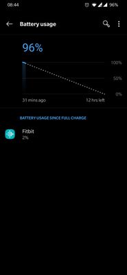

Please note the battery consumption shortly after unplugging the phone from the charger:
Only Fitbit draining battery while certainly I did not activate any activity tracking with GPS. To stop that, I have to start an activity, wait few seconds, then finish it, then delete from dashboard...
