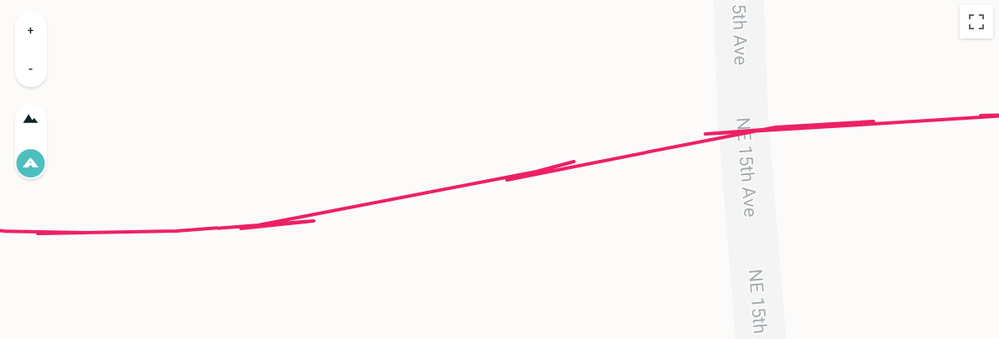

I've been using the Fitbit app on my Android phone(s) to track walks and runs for years. It has always been the most accurate tracker compared to others I've tried in the past.
However, since the end of April 2021 (29 or 30 of April I believe) the distance the app shows is significantly higher than what it was before.
For example, a walk I've tracked tens of times in the past between 2.16 - 2.18 miles, will now show 2.9 miles.
Taking a closer look at the map in the app, I noticed that there are many small backtracks, even though I never backtrack on my walks. Here is an example:
Looking back on maps of walks before the end of April, there are no backtracks like these.
I exported the .TCX file of one of the walks and I used a GPS map editor to delete all the backtracking points. The total distance of the walk after that had dropped to inside the range of the correct distance.
For further testing I tracked a couple of (the same) walks with both Fitbit and MapMyFitness. The distance measured by MapMyFitness was very close to the correct distance, but that of the Fitbit app was 10-20% higher. I analyzed the .TCX files from both apps and while Fitbit had many backtracks (like the map above), MapMyFitness had none.

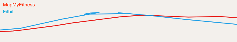

Hi @MakMak, thanks for taking the time to check your app and reply!
Yes, for the past 10 days I've been using both the Fitbit app and MapMyFitness to track my daily walks. Every time Fitbit has backtracks while MapMyFitness doesn't.
I downloaded and analyzed the .tcx files, which give a long list of trackpoints (with coordinates and timestamp) during the exercise, from both apps. MapMyFitness takes more trackpoints (2561 vs 1626 for a 40-minute walk) and had no backtracks. Fitbit has many. Here is an example screenshot of the two tracks zoomed in:
