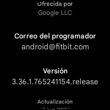

  • Google watch 2. Fitbit app version 3.36.1 (full version in screenshot, because the forum thinks it's a phone number and it wouldn't let me post it in full), no updates to be found as of now.

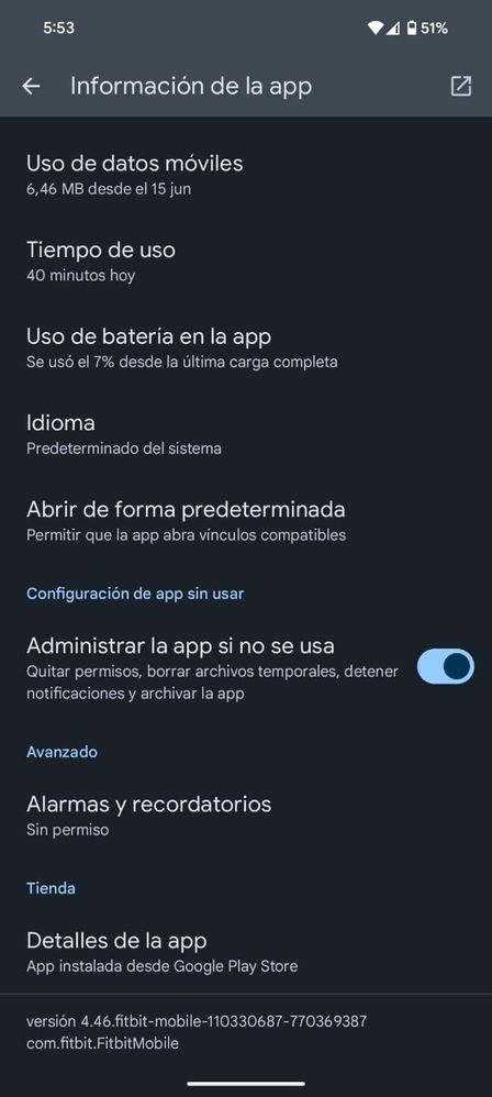

  • Pixel 8 Pro. Fitbit app version 4.46.fitbit-mobile (full version in screenshot, because the forum thinks it's a phone number and it wouldn't let me post it in full), also no updates as of now.

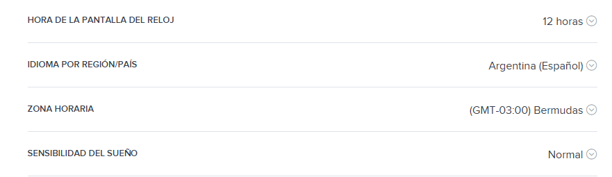

  • I've set up the time zone manually to GMT-3. Also changed to an incorrect one and setting it back to the corret one.
  • Iv'e checked in https://www.fitbit.com/settings/profile and the time zone is correct.

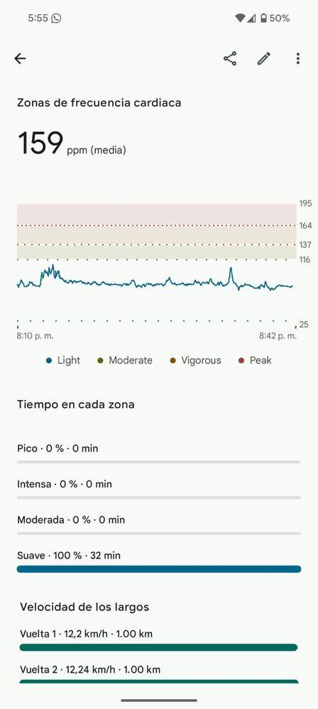

I'll leave an example of an exercise. We have in big bold numbers the average ppm of 159, and the graph visible never goes over 116, the zones do correspond to the graph.
In actuality, the big bold number is correct, but i checked and the graph (and zones) correspond to 3hs later. So we see in a same screen there is something wrong.

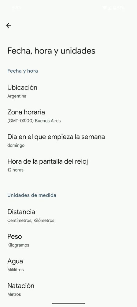

Try this: on the watch itself go to Settings -> System -> Date & time. Toggle off "Automatic time zone". And in the "Set time zone" pick a location with your time zone.
This seems to fix it for me (Pixel Watch 2) and my gf (Pixel Watch 3). The heart rate chart started showing correct timestamps. In the Fitbit location and timezone are set to automatic.
@ExxaD Sorry for the late reply, but i had a minor injury and i couldn't exercise and test this. But indeed, today i tested it and setting the timezone manually did fix the issue. Well, not fix it really, but at least is register the data as it should.
I had tried to set it manually to another zone (being the correct one, or another completely different) to "reset it", but i always set it up to automatic so i never tried to keep it manual.
