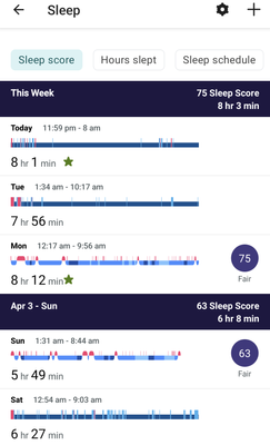

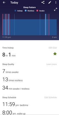

Does anybody know why my Fitbit app (android) records 2 different sleep patterns?
I would like to see a detail of my sleep patterns like the 2nd photo which displays REM sleep.
I do have my Fitbit watch heart rate monitor set to always on and the sleep mode is set to normal (not sensitive).

04-13-2023 07:36
04-13-2023 07:36
Last night, I didn't use the "begin sleep now" and for some odd reason the Fitbit app recorded 2 logs. First a long and then a short log (around 1 hour), but neither displayed sleep score only pattern and it displayed a message that it could not give me a sleep score because it could not consistently detect my heart rate which is weird because I can go back and see that it did detect my heart rate throughout the night as I slept.
I went online and found another forum where people were having the exact same problem as me and one person said to delete the log and then manually add the sleep log to it. I did that and it halfway worked. It did display my awake, rem, light, and deep sleep info, but did not give me a score. I don't care about the score, but I do want that other info. So, I went back and deleted all past sleep logs that only displayed sleep pattern and not score. I then manually added the sleep log and then it displayed the other sleep info that I wanted, and some did have the sleep score with it.
Looks like I will need to add each sleep log to it to get the score info that I want.
