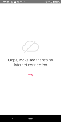

Hey, yesterday I updated my Fitbit to the new firmware and I tried to make some changes but when I press on clock faces or anything I get the error message "oops looks like there is no internet connection".
I cleared the cache, what else to do?

I'm using a Oneplus 6 and I'm positive that it is not my internet connection as both cellular and wifi work just fine. My wifi network is not the problem and I have more than enough experience to rule that out.
The error is produced like this;
- Click on profile in the top left corner
- click on the Charge 4 that is connected to my account
- Click on clock faces, apps, spotify
- it shows a white screen with a grey cloud icon with a stripe through it in the middle with a text underneath it "Oops, looks like there's no Internet connection" underneath that there is a Retry button that is all.
I tried to delete cache, didn't work
Rebooted my watch, didn't work
Delete the storage of the app, basically reïnstalling it, logged back in and it still didn't work.

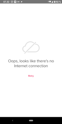

Same issue on Android with a Versa.
Both with Wifi and without (using the phone's 4G internet) - also with and without dns.adguard.com set as Private DNS (makes no difference).
I have tapped Retry hundreds of times botn continously and each month for the pase year or so. Every other app can use the Internet and Fitbit can even check for firmaware updates but no apps clockfaces etc. Been like this for a year I think.
I've never added a wifi to my Versa btw but apps and clockfaces etc worked nicely anyway - but stopped at some point - perhaps due to a firmware upgrade.
