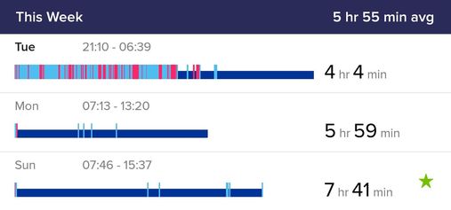

I also ran into another (related?) bug. While changing timezones the app at some point showed a double entry for the automatically recorded sleep, so I deleted one entry. After the sync the original entry was also gone. When I manually add tonights sleep (21:10 to 6:39 in this case) though, the app shows it correctly for a short time and then changes it to 4 hours 4 minutes of sleep and adds 38 times awake 39 times restless randomly to it (screenshot attached). On the app dashboard the time also shows up as 4h4m but from 14:40 to 00:09 (so GMT again). For past sleep tracking the app dashboard would show the correct GMT+6.30 time (same as the browser version).
