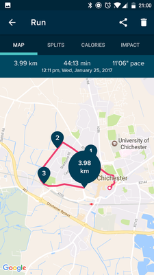

During runs tracked on my android the time is correct but the GPS and distance (and pace) are inaccurate. i have recently switched from iphone where it worked close to perfectly evertytime....Does anyone else have the same problem?
The time is approximately accurate but the distance should be 5k as it's a measured route. The map is something close to accurate but doesn't cover the whole 5k route....

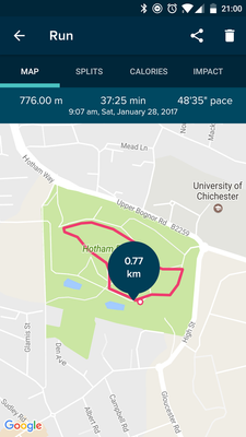

Again the time is accurate but the distance should be closer to 6k. The map worked up to a point (where the line suddenly becomes straight and veers off) but didn't continue to the end of the route...
