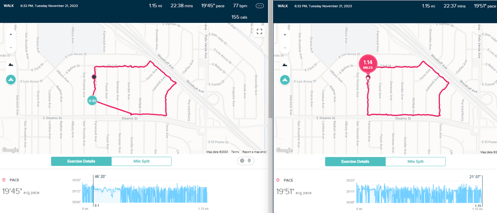

My wife and I went on a walk tonight. We both tracked using our PW2s. My PW2 lost GPS after just 0.1 miles! My wife's tracked just fine. Interestingly, we both came out at 1.15 miles at the end of the walk.

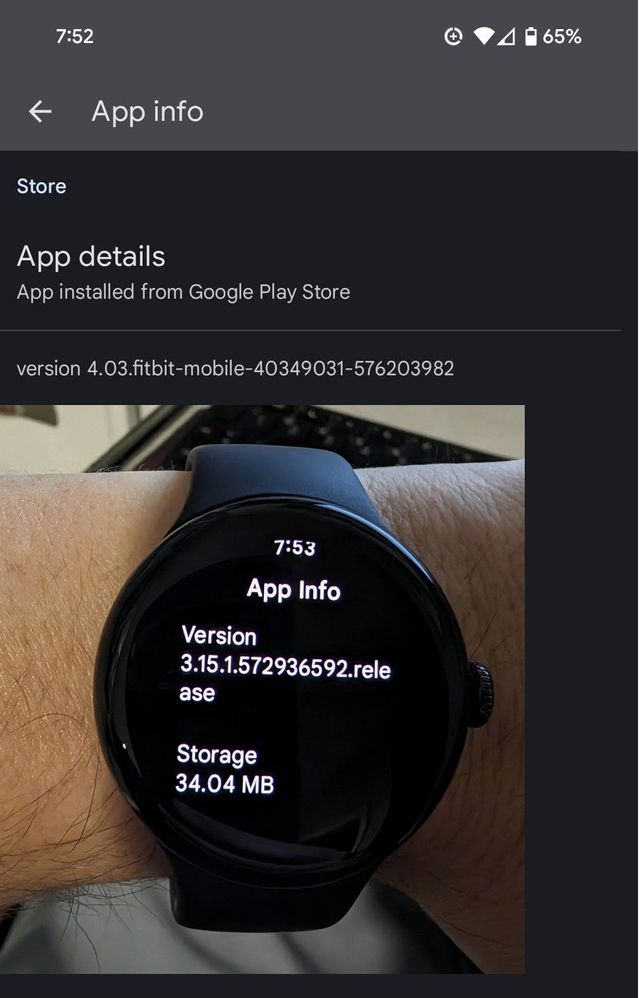

Couldn't get this to post with version numbers typed out for some reason so I had to mash up a screenshot and a picture.

Fitbit support emailed back that the phone app is updating to v4.04. I'm not sure that affects the watch app and fixes things. I can't see the update on GPlay yet...

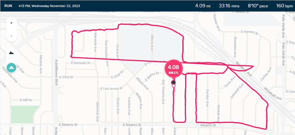

Another run this afternoon, another GPS dropout. That makes 6 out of 8 runs/walks that have had GPS dropping out. Not that I was expecting anything different, just wanted to document that the issue still persists.
