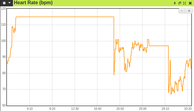

@goryn you may have paused for longer than you thought. The pause is quite clear in the data (you don't need to guess how long it was because it can be calculated which is exactly what Strava did showing the moving time). There is one more chart you can see that shows the duration of pauses and where they happened. Fitbit doesn't collect HR during pause so here's what the HR graph looks like for you for elapsed time (long horizontal lines are for no HR readings):
You can clearly see a very long pause almost at the beginning of your ride. How it happened, I can't tell because I don't know exactly. Something happened the watch paused around 00:01:43 and unpaused at 00:19:44.
The bug however lies in the presentation of the data. One chart shows your moving time, and the other shows your elapsed time. This inconsistency is a bug.
