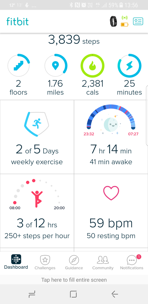

Further to this I have just noticed that the Dashboard now always shows my sleep time as 7hrs 14mins and weekly exercise as 2 of 5 days and my 250+ steps per hour as 3 of 12 (see screenshot attached) which is the sleep data from yesterday and the 250+ data from today so far.
If I click on the tile it displays the correct data except for the dates between the middle of October and January 9th where it seems nothing is logged at all. So my initial problem seems far worse than I thought!!

Hey @PeterH62.
Thanks for those pictures.
I'd like to quickly address your second inquiry. In this case, that is the way the app is supposed to work, so no issues there. The only tile that cycles through the days is the main one (the one at the top). All of the other tiles only display today's information. To get the information for older days, you have to tap the tile and go into that section of the app.
