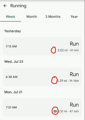

Hello - In the last month or so I've been experiencing an issue on my Pixel Watch 3 randomly deciding not to log GPS data with my run resulting in the Fitbit app not logging it as an exercise day despite the fact there is the entry of a run under a particular day with heart rate data, but that's all.
I'm also marathon training with friends and syncing my runs to Strava, but since there is no GPS data, it's not showing up there either! The issue is exactly the same as this one reported last month in June:

Like the user on this thread, I'm not doing anything differently on Wed/Thu as I did on Monday, but only Monday had GPS data. I am doing a big run tomorrow and will test it today if I can post-reboot to ensure it's working again.

This has happened to me twice now, so I'd really like to get this resolved if possible. As the other user(s) reported in the other post, when you're in the run, the metrics look the same, though I did see it say "connecting to GPS" multiple times when I had open views of the sky on similar routes where it's usually not a problem - so seems to be a bug of some sort. At that point though, you've already lost the data, and unless you're willing to STOP your run, reboot the watch etc. you're out of luck which is not conducive to my training plan and defeats the whole purpose of why I bought this watch!

I've been able to track runs on as low as 30% when I've neglected to charge the night before and want to say in this case earlier this week I was not below 50% for at least one of the two days it didn't record (Thursday) as it had been charged the night before (no restart between days where both runs the watch failed to log GPS data).
