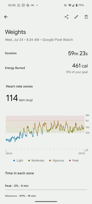

I am experiencing an issue with my Pixel Watch where the Fitbit activities are always displayed 3 hours ahead. I live in Recife - PE, Brazil (GMT-3). My "date and time" settings and timezone are set to detect automatically, and the time on the watch is displayed correctly. During my travels in Europe and even when I was in São Paulo, the activity timezone was recorded correctly. However, when I return to Recife, it goes back to recording activities 3 hours ahead. For example, if I go to sleep at 10:00 PM, the watch records it as if I went to sleep at 1:00 AM. If I wake up at 6:00 AM, it shows that I woke up at 9:00 AM.

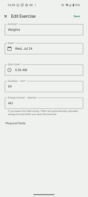

Additionally, the logged exercises are also displayed with 3 hours ahead, but when I select the edit option, the correct time is shown.
