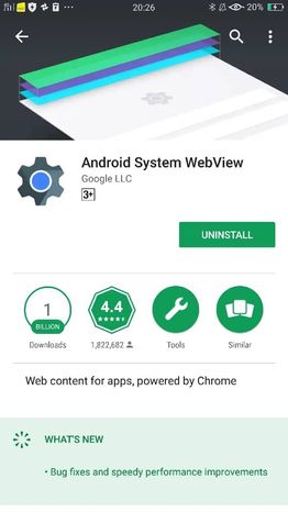

Hello Nitinsoni
Here's the link to the app on Playstore - [ https://play.google.com/store/apps/details?id=com.google.android.webview ]
Or you can just search "Andriod System WebView"
here's a screenshot.
*disclaimer Smiley Happy This solution works for me...I won't be responsible if anything goes wrong with your device.
and most importantly! good luck and hope this helps

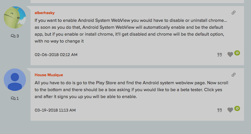

This is beyond my territory but what i found is - Andriod System Webview has been replaced with Chrome with the newer Android OS's.
Googling other forums, seems like you're not alone...here's the responses that seem helpful / sounds legit.
Good luck!
