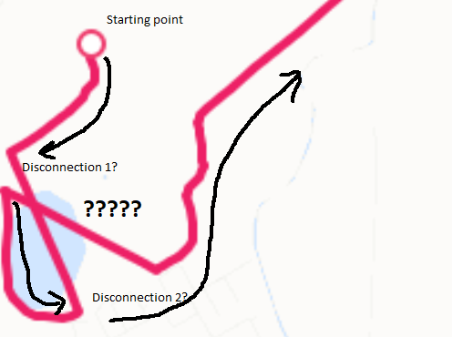

Secondly, often the connected GPS feature is totally useless. Sometimes it works fine, but usually the result is not worth of anything. I understand that it might be issue with the phone and device losing connection, but there seems to be nothing at all to compensate those disconnections. In example, if the device loses connection and I travel for like 2km to any direction, that 2km is lost. So there is just straight line from start of disconnection to end of disconnection and the distance between them is ignored. So app just presumes that I have teleported between those locations. Lately I have seen really strange GPS results where it seems that I have been going backwards. It is hard to explain, but from the results it seems that I have been going to other direction that I actually did. This usually presents itself with disconnections that I explained earlier. I have one example where I seem to have 2 disconnections pretty early on my route. The App connects the line from starting point of first disconnection to starting point of second disconnection. And again ending point of first disconnection to ending point of second disconnection. This causes really strange line to be drawn as my route. Picture showing this below. Red line is the Fitbit route and black shows the actual direction.
Strange GPSStrange GPS

Now regarding the issue of the incorrect map course, there are some reasons that might interfere with the connection, resulting with an incorrect map. One of this reasons can be the environment you are in since it  an affect the signal strength of GPS. For example, if you are running in an urban environment with many tall buildings or threes. So at the moment it lose connection it will try to pin point your location by an approximate location or the nearest GPS connection your phone can find.

Well buildings are not the issue in my case but trees might be in some cases. But still this issue is only present in connected GPS(from exercise shortcut from the tracker) and not the manually started one(from the phone App). And losing GPS connection should not give that kind of path in any case. That seems to be a bug.

Same problem with the connected GPS still exists. Usually it calculates the distance as half of what it should be, though the route on the map is still correct.
