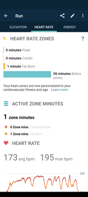

When I look at a workout I just completed in the app, my heartrate seems to have been tracked accurately but the zones say 0 all the way through. Has anyone run into this/have a fix? I contacted support and they said it's because autotrack conflicts with manual tracking and clobbers the data, but I then disabled autotrack and this still happens when I manually track a workout.
I'm using the Pixel Watch if that's relevant here.

Thanks for the explanation and the screenshot. That has happened to me before but it was only a one time issue and it was with tennis, if I remember correctly. I will have to check again. However, it has been working with my last workouts. Pleas make sure that your Fitbit app is up to date.

Pixel Watch, Andorid App. Both up to date and restarted.
Run exercise triggered from the watch when away from home without the phone and without cellular connection.
Heart rate seems to have recorded correctly, but for the last two days the HR zone has not been recognised correctly.
Normally I exercise in the gym with phone(data connection available) and the zones are recognised. Not sure if that is relevant?
Any Ideas? Thanks!

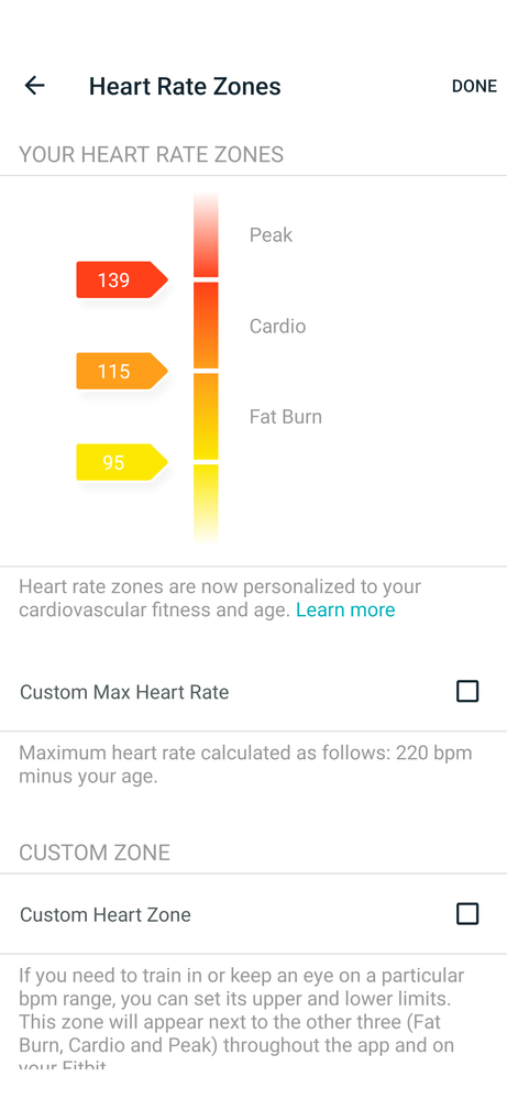

This same thing just started happening to me -- and it's been consistently wrong for about the last week. Before that, zone minutes worked; now, it seems to think I'm in only in the fat burn zone very briefly and never rise above that despite the Heart Rate Zones (these are the defaults -- I haven't changed them) clearly showing I should be in one of Fat Burn, Cardio, or Peak most of the time. I have the latest FitBit app (last updated about a month ago) and a Pixel Watch and phone (both also fully up-to-date).
