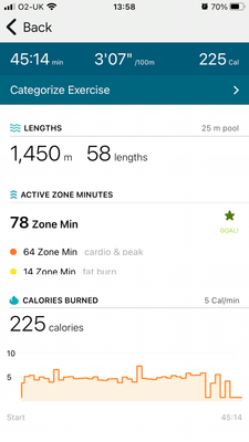

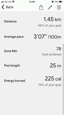

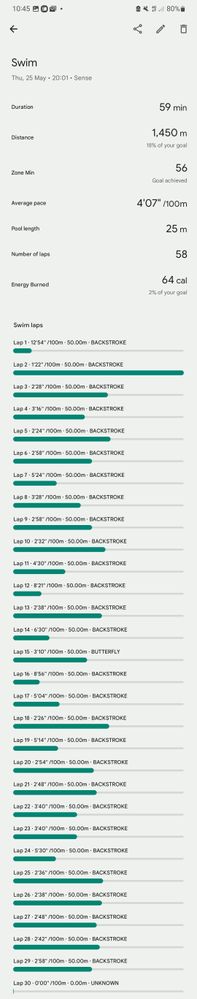

@FFatbit you need to open the exercise details and it's going to be there as "Number of laps". The data is correct, but the label is not. Lengths and Laps are not interchangeable on Fitbit as shown screenshot below (25m is a length, and 50m is a lap in the current Swim activity setup):
In the screenshot above distance (1450m) divided by the number of laps (58) will result in 25m which is the length of the pool. The laps are 50m long and listed at the bottom and the number of laps is 29 not 58 (half as the lap is set to be 2xLength in this swim but it may be set to other distances on the watch).

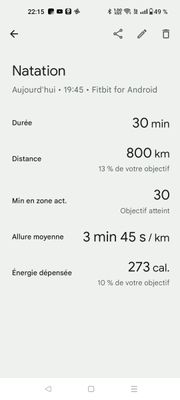

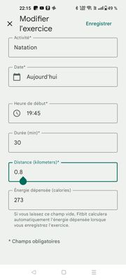

If you add manually a swim, length could only be set in kilometers... if you set 0.8km for example, 800 kilometers will be saved...
That worked perfectly fine in the previous app version!

Even worse, if you have miles set as main unit of distance but metres set as swim unit, the ap now forces you to enter distance swum in miles (which is almost impossible when swimming lengths of a 25 m pool) and then converts it into metres after saving. Very annoying

@caveman60 noticed that when tried to correct my last swimming distance. It mixes up units. I wrote once that Fitbit doesn't understand sports, they don't know what runners, swimmers or cyclists need and so far Fitbit doesn't try to change my mind. Pool swimming distance in km or miles... 🤦 When other brands improve on available metrics (SWOLF, stroke rate, strokes per length, moving pace, drills and many more) on Fitbit users can't even edit the pool swimming distance using the correct units and scale.

@FFatbit now I see the pattern. Lengths are missing for autodetected swimming. If you swim using Swim exercise then you'll see lengths (but you will lose HR). Well, just another inconsistency.

What's more, when I'm trying to enter a swim manually (to correct the miscounted lengths) it no longer allows me to do a decimal for how many miles i did. It only allows whole numbers.

@BG73 you can use a decimal point. The text field will show an error (red border) but if you save it, the value will be accepted regardless.
