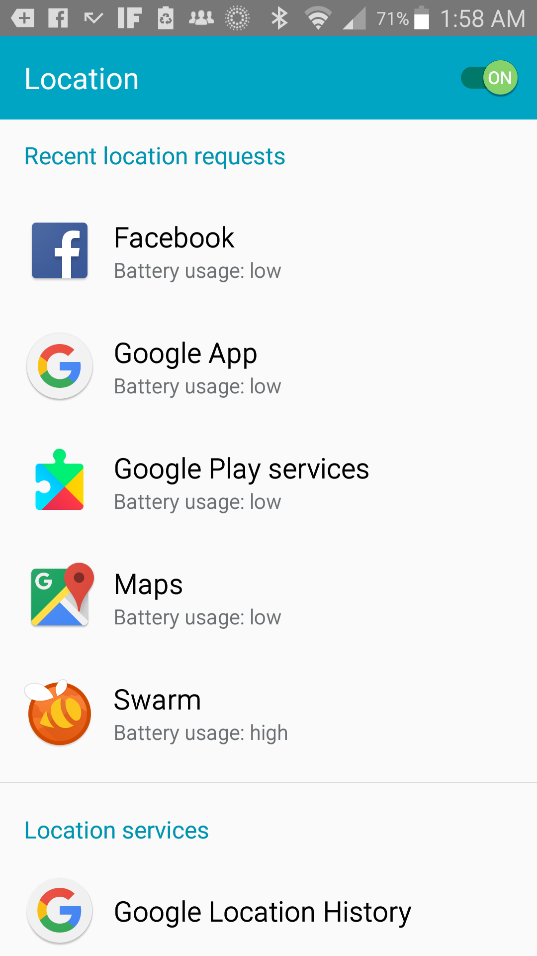

@dcolpi you can do your own research, fitbit does not request location during a sync. I just successfully synced my Blaze and here is a list of recent apps that requested location.. Do you see Fitbit listed?
All I know is that, while using Android 6, my FitBit requires access to my GPS location.  If I do not grant it, it does not allow me to sync over bluetooth.  I can't immagine that they require access and not then use it.  However, I also don't understand why they need it, unless the FitBit developers misread the new Android requirements for Bluetooth communication on Android 6, and incorrectly are using fine location (vs course).
Sorry @dcolpi, the message is not asking for access.. It's asking you. To turn on location,, itbit does not access your location at the time of a sync. Fitbit requests the MAC of the device that is being communicated with, unfortunately in Marshmellow location has to be on before the MAC address is handed off to Fitbit.

I think you mean GPS not GPRS, turning on location services does not turn on any gps. When an app requests the GPS it will get turned on.
Actually the user is unable to turn on or off GPS, that is up to the app.
Location services has 3 modes
High accuracy -. WiFi and cellular - gps
Power saving - WiFi and cellular
Gps only - GPS
During a sync no location is requested, there for no location will be calculated and no radio will get turned on.
