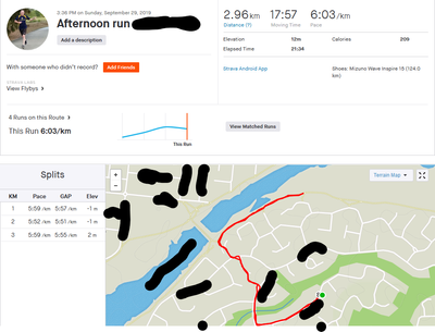

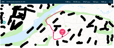

I recorded a short run at the same time on both Strava and Fitbit to show how bad the connected GPS is with the Fitbit app at the moment (The Strava recoding is the correct one below). Strava shows a shorter duration as it auto-paused when the person I was jogging with stretched. Excuse the markings - just trying to anonymise a little. The fitbit really is useless for recording activity at the moment.
Fitbit 1.97km:
Strava 2.97km:

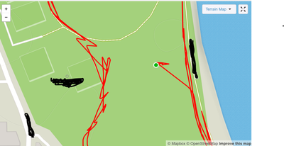

I too have been having this issue with Charge 3, Android 10 on Pixel 2XL.
My runs have been coming up 10% longer than before, and also when I run the pace is shown as being way faster than expected. Including occasions when I was being told a 4:30 min/km pace, and my running partner was getting 5:30 min/km.
Some runs have had weird zig-zags and double backs, that I can assure you were not real. See thjs snipped from strava. This is two laps of a course, the green dot is the start.
Some of the distance issue could be because of the erroneous double-backs.
I have had similar issue on routes where no double backs are visible.
