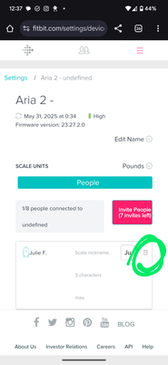

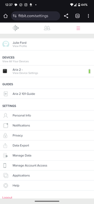

I *just* reconnected mine after 696 days since last synched. It's a process, but I gotchu (hopefully 🤞🏻). First turn your phone's Bluetooth ON, then proceed:
1.  Go to www.fitbit.com/settings
  •  Go to your profile and hit the trash can

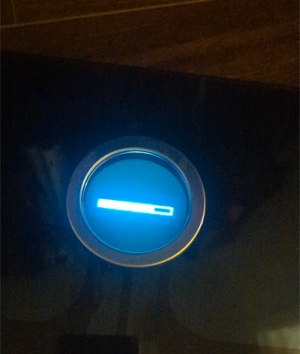

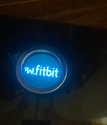

2.  Reset the scale:
  • Remove one battery, wait 10 second
  • Keep the tiny WiFi button pushed in while you place the battery back in. DO NOT LET GO, it's difficult.
  • Keep pressing the WiFi button, I did it for a good 30 seconds and released.
  • You'll see a loading bar on the display. Then the usual "www.fitbit.com/setup" - but that is a dead URL.
