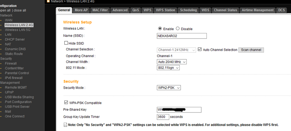

Here are the settings of my wifi, I don't see what is wrong .. is this some issue with the scale and going to the vendor to get a new one will fix the issue ... what are your suggestions .. (as well is that normal that the scale turns off quite fast .. batteries are full ... I can see them on the fitbit app

It was the scale the issue .. I returned back ... and got a new one
I even wen't to my neighbor to test the wifi same problem, .. the scale displays set-up and turns off right away, as I mentioned.
This morning I went to the vendor, returned the aria 2 and got a new one, exactly identical same model and color (aria 2 withe)
Back home, it connected like a charm to my wifi, the scale didn't turnoff during during the set-up, it connected right away and works fine, now I can see results in the fitbit app 👍
