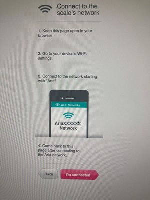

My Aria 2 scales lost wi-fi-connection after years of working fine. The setup advice isn't working for me. I follow the steps so far as it goes. When I get to the part where my phone's Wi-fi networks page is supposed to show ARIAXXXXXX NETWORK on the available wi-fi connections, there's nothing listed to connect to. And I have nowhere to go!
Help appreciated! Nothing in the house as changed. The link was working fine. It just stopped and now I can't reestablish it!

@FranKeeley   Your third screenshot looks like it is from the Aria (original), not the Aria 2 setup.  It says to keep this page open in your browser.  The Aria 2 wi-fi connection management is entirely on the mobile app.  Tap on your profile avatar on your mobile app, then your Aria 2 tile.  Tap on Wi-Fi Connection on that page, then follow the steps to reconnect your scale.

Thanks so much LZeeW!
That worked and you made me happy! 🙂

The third screenshot was the key.  Glad I could help.
