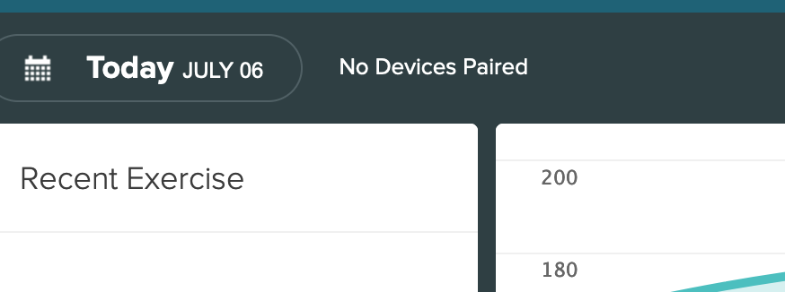

I am seeing another issue, but it is very minor. When I click on the DASHBOARD link when in my account (on a browser on a computer), on the top directly over my tiles, it reads NO DEVICES PAIRED. I've included a screenshot of it.  I am assuming it should be showing my Aria as a paired device?? But it's clear that my Aria is paired because everything is working now - my weight is being recorded from the scale to my account perfectly. It just reads on the dashboard that it is not paired... which is not a big deal I guess, but it's pretty bloody annoying. Just thought I'd share that.
