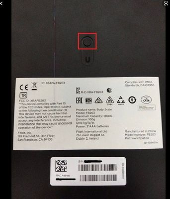

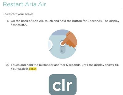

First and foremost I apologize for the late response. I’m just seeing this post for the first time. To answer your question I’d recommend restarting your Aria Air scale. I’ve had the same thing happen to me as you described after replacing the batteries. I had to remove the batteries again for about 8-10 seconds first. Put the batteries back in then perform the restart. Here’s how:
The reset button is located in the rear of the scale (see image)
