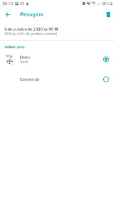

How can someone puts this as "solved" when clearly its not...
Can you explain how the number will show up if whe we weigh it puts it self to 0? 
