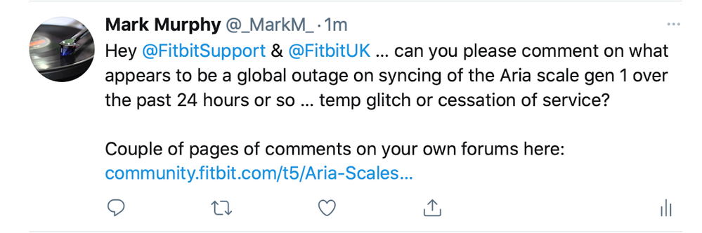

01-07-2021 02:30 - edited 01-07-2021 02:30
Yip, same issue here ... thankfully found this thread which saved me a lot of wasted networking troubleshooting effort!
Just sent a tweet to Fitbit to see if that flushes them out!
