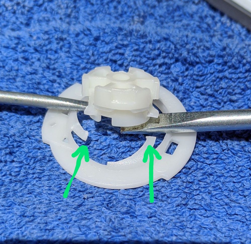

Today, I opened my malfunctioning Aria scale, and found plastic that is not suitable for the job, broken in two places.
Too bad for me that it wasn't designed correctly.
Two of three legs broken, on a foot support

The scale seems to have a problem with poor build quality, sometimes fixable by opening it up and rearranging the wires so they aren't pinched by internal plastic ribs.
Or cheap plastic parts supporting the feet, that break. I think this is the problem with mine, although I haven't taken it apart. Fussing with the feet made mine work for a while.
For reference - I used this video to figure out how to get the back off the scale https://www.youtube.com/watch?v=dDEvXJIW4lY
And a 3D printable replacement plastic part, if you can print:
https://www.thingiverse.com/thing:2988535
