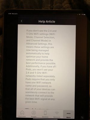

Here is the message I get when I try the proposed solution:
I can live with the fact that the Aria only use 2.4 GhZ: there is no much need for bandwidth for transferring weight data measures a couple of time per day, ...and 2.4GhZ can be transmitted at a higher distance.
However, when you get top-of-the-notch router upgrades (like meshes), the network infrastructure use the same SSID for several satellites and for all frequencies (2.4GhZ and 5GhZ) ...and it is not normal that the presence of the 5GhZ band complementarilty to the 2.4GhZ one would ennoy the FitBit Aria. Activating 2.4GhZ is an option. Disabling 5GhZ is not an option.
I saw in the Netgear forums a suggestion that the issue is when the same SSID si used for both frequencies *at setup time*.
A workaround seems to be to go to the Netgear router to "temporarily lower the power of the 5Ghz band signal" and setup the scale at a distance from the router so that it can see only the 2.4Ghz signal and not the 5Ghz one. Once setup, it is in principle OK to be closer or or to have the 5Ghz signal power back to 100%.
I didn't try yet.
