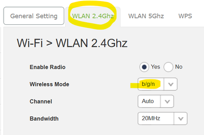

Hi  .... I had this problem too and had to go into my router admin settings and make sure the Wifi  for the 2.5Ghz was set to b/g/n wireless mode ..and not just the g/n or n only .. that allowed me to walk through the set up on the Aria scale to connect to the Wifi finally!
Scale still doesn't upload the weight though.. seems like the move to google has possibly messed up some of the functionality.
