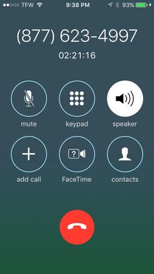

I have gone on the website and assigned those measurements to myself with several weigh ins. The issue persists. I did every step from your help article at https://help.fitbit.com/articles/en_US/Help_article/Why-is-my-scale-recognizing-me-as-a-guest
I asked FitbitSupport on twitter for what to do. They directed me to other support channels at https://twitter.com/FitbitSupport/status/671125370855292928 where I got the contact number.
Now I am on hold for Fitbit to answer. It has been over an hour and 45 minutes. While I wait, can anybody help me fix this issue with my Aria scale, please?

I gave up holding for phone support after 2 hours and 25 minutes, so any support here would be much appreciated.
