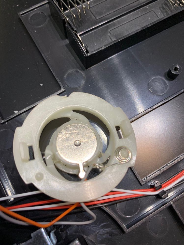

My Aria is doing the ERR thing as well. I had previously switched my router about 2 months before and had to reconnect, but I don't think this is related. I have had my Aria for 3 years now and this is really the first problem I have had with it other than changing batteries.
I am up for Aria surgery to see if I have the broken part.
Great! I tried to glue mine as well. An arm was broken on two leg-sensors. I used super glue gel
I reinforced the remaining arms, while it was out and the glue was open

Sadly, the superglue did not fix it - still the same exact problem, 'Sensing' then 'ERR'.
I don't want to try gluing the parts again - but might try 3-D printing replacement parts as a design / blue print exists.
