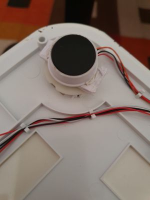

My scale was giving consitently showing the 'step off' sensing message. I read how to open it up and look inside and sure enough, the plastic mounting bracket that holds one of the sensors was broken. Support told me that I was out of warranty, replacement parts are not available and there is no repair option.
Since this is not only, the most expensive scale I have ever purchased, but also the most short lived scale I can not recommend that anyone purchase it. If someone in support can contact me and give me a repair option I'll change my tune.

@JuanJoFitbit if I was able to print this broken part with my 3D printer and offer it to the people in need at no cost (except postage), people who are on the edge of throwing this scales away as being out warrant and there are no replacement parts for them... Would you have anything agains this?

Just waiting on @JuanJoFitbit to confirm they are ok with this, I don’t want to get in trouble with FitBit. I’m not asking for their blueprint for the part since someone had already designed the part and I have printed the part and tested and fixed my scale, not asking for Fitbit to support me in any way, not asking for any money for plastic I use or for the printer usage time which takes about 40 minutes to print one leg/part.
All I need is for FitBit to say, sure go ahead we have nothing against this since the scales are broken, out of warranty, we have no spare parts for them anyways.

@Scorkey there’s more details on my blog https://vio.au/3DPrinting
I’ve printed a few, just use the message below the post on the blog to help you out.

Okay, so having Googled the crap of this I have determined that
a) Fitbit support sucks and I will never buy a product from them. Ever.
b) None of the other solutions are really viable due to my location.
So I went old-school and just jammed 2 small supports (ie. Folded up pieces of paper) in between the feet and the broken flimsy plastic thingy.
Worked a charm! No more dead battery, no more "step off step off step off step off" and checked the accuracy and it appears to be spot on!

Need to work up the courage to open it up again for fear of breaking it...
But if I do I will def. post a pic here.
