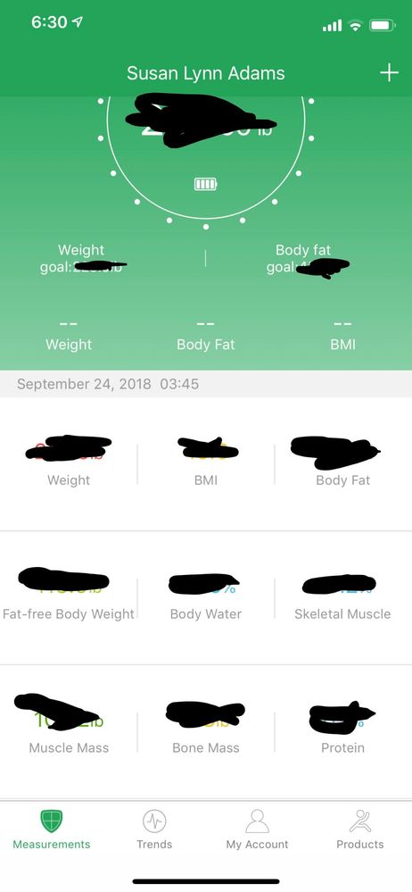

Renpho scale
I converted to the Renpho scale someone else mentioned. Under $30 on Amazon and its rechargeable. Works off Bluetooth instead of WiFi and connects to Fitbit. I’m liking it so far!
