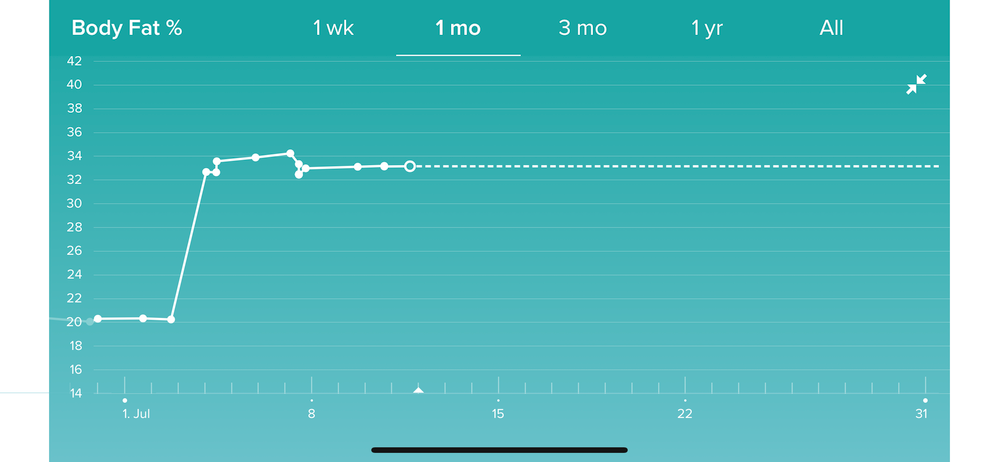

I have the same issue. My BF was usually constant at 21% and it suddenly jumped to 36%. The measures were taken a day apart. It started measuring wrongly around July 3rd , more or less when I update the App. I am not sure if it is related but it is really suspicious. Does anyone know a solution?

I have reset it several times, I.e., removed the batteries and tried to calibrate again the result did not change. It started about a month ago 😞

There was App update today. I think something has been fixed because after the update it started to work again
