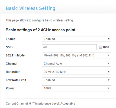

I had this issue setting up my gf's today, tried everything to no avail and finally called support. We determined that my router profile had to be changed for the Aria to connect to it. I told him the brand name of the router and he googled how to change the router settings and then walked me through how to fix the router profile in order to get it working. Took 45 mins but was so worth it in the end, the guy was super patient and we got it working!
02-02-2017 17:39
02-02-2017 17:39
So what he did was neuter your router so the scale would work. That is exactly the wrong way to fix this; he has set your router back in time to 1999 capabilities (literally).

Can you change it from n to b?
04-25-2017 03:34
04-25-2017 03:34
This was it for me - when I set up my new router I turned off old wi-fi standards that surely nothing uses anymore..... Right?!
05-10-2017 17:34
05-10-2017 17:34
This worked for me. I deselected the "Enable WMM (QoS)" option for my 2.4ghz (802.11b) network, saved the change and finally my network showed up. Hope it works for you
