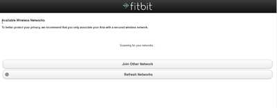

I have tried both the iphone and laptop. I can not get it to connect to my new wifi ... want's to stay on old wifi. I can get the scale to the setup mode but that is as far as I get.

What are the specs for your new wifi? Is it 2.4 GhZ

You have just answered why your question as to why the scale can not see your WiFi.
You will need to enable the 2.4 ghz WiFi or link your old router to your network for the scale to work.

@moTMan the Aria only has WiFi to communicate through. Don't. Blame fitbit if your routers firmware was out of date.
@DoubleTapJack open the Fitbit app on the phone. Tap Add device and choose the Aria scale. Follow the directions.
You need to pull the battery to reset the scale. This also sets the Aria WiFi. To default.
Now follow the directions and connect the phones WiFi to the Aria scales WiFi. Once connected, hit continue on the app.
