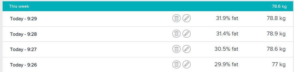

Hi - I just set up my Aria scale to sync with my new wifi and was surprised that the result was more than 2kg less than when I weighed myself not connected earlier this morning - about 30 mins before.  So I investigated by first putting it back where it normally lives - still came in 500g lighter and completely different fat results.  Tried several times in different places - all on hard floors - and different results each time 😕
Anyone experienced this?  Have any ideas?

There's a section in the Aria 2 manual that says:
"If your Aria 2 is picked up and moved between measurements, or stored sideways against a wall when not in use, the scale will go through a calibration process the next time it is used for weighing. Up to two consecutive weigh-ins will then be required before your scale is recalibrated and again displays consistently accurate measurements."
I assume this is the same for the Aria. I keep my Aria 2 in the one place and it's been consistent for me. Perhaps leave it for a while and see if it settles?

@LucyB62 It's great to see you in our Fitbit Community! The information that shared my friend @SteveH about the weight variations is totally correct.
If you still having the same issue even after re-calibrating the scale, let @SteveH and me know and we'll be happy to assist you.
