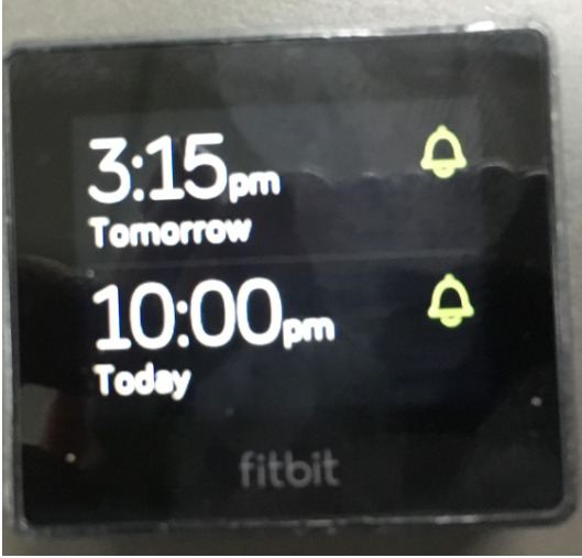

Hey there @Robert.M and @Houstonnick! Thanks for the additional details that you've mentioned. I just tried to set some alarms in my Blaze and they showed in a chronological order. Please check the screenshot below:
Additionally, can you provide me with a screenshot of what you're seeing in your Blaze when you set the alarms?
